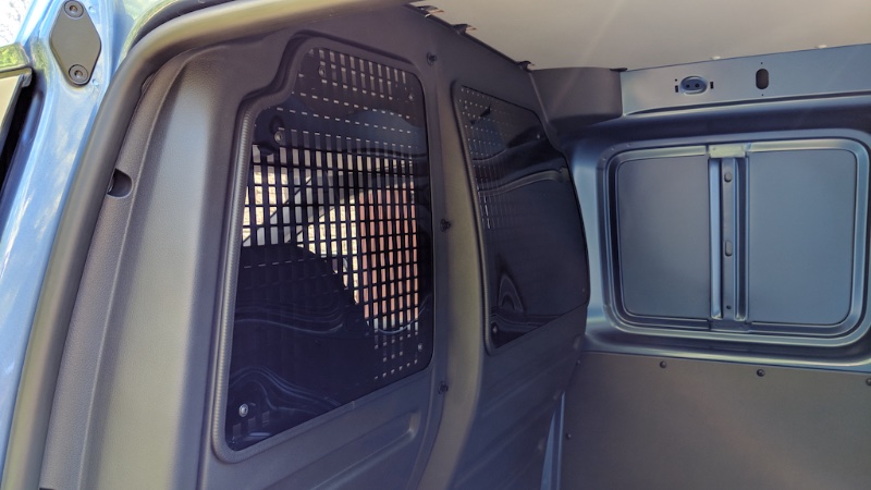

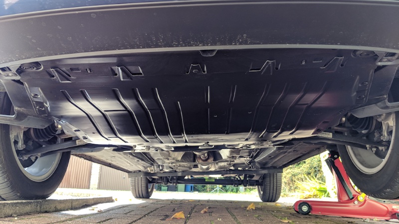

The first week of owning it, all still standard. First thing I've done is fitted the perspex sheets to the mesh bulkhead, to cut the noise down. Made quite a bit of difference I have to say. Then fitted the undertray to keep the engine bay clean.

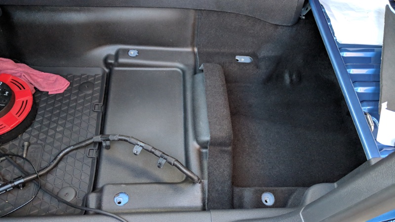

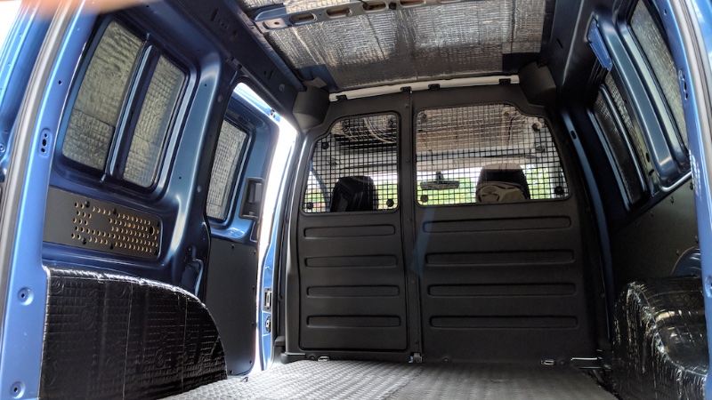

Sound deadened and fitted the OEM carpets behind the seats. This further reduced the road noise by a bit.
Started sound deadening the back. Applied 2mm Silent Coat sheets to the single skin side panels, roof and floor, 3mm sheets to the wheel arches. Need to carpet next.

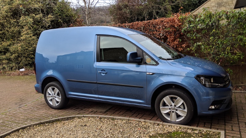

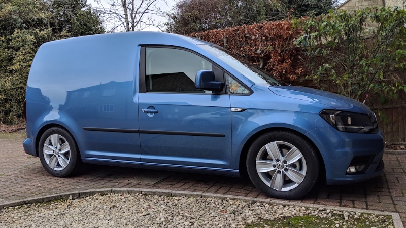

Lowered with AP coilovers. The rear is on the lowest setting, but the front still can go about 3cm down. May need to get a superlow shackles from Darkside, as I still want to go a little bit lower
Before lowering After lowering
