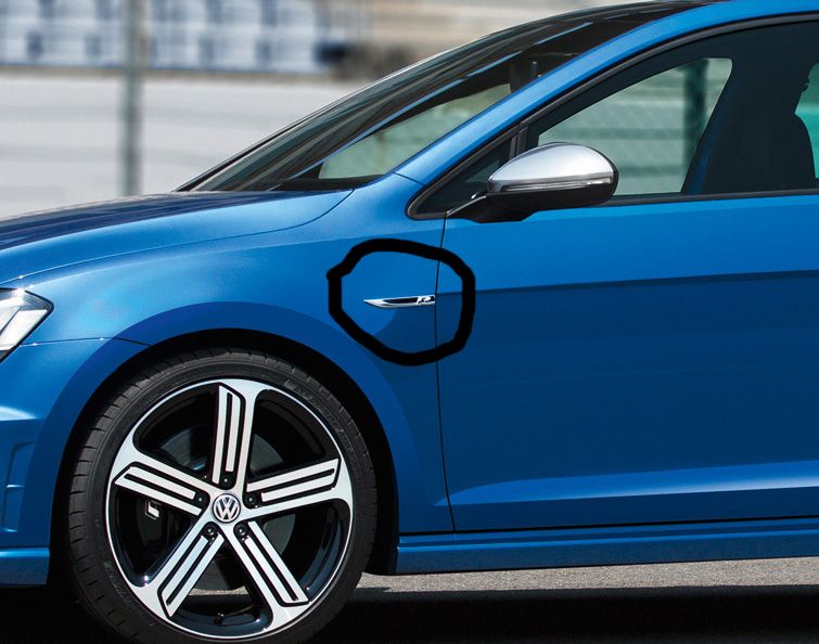

Hows about some of these for the sides but in gloss black. hopefully the picture will come through.

I've been on the fence about badging. I've got some R Line badges but think as I've [and Reflex] gone to so much trouble removing the VW badges that adding any will take away from the theme. Ultimately my whole concept is "A VW Caddy R (as if thats a genuine VW model) that I've modified trying to keep some of its R DNA but being unique enough that people know its mine".
I think I will wait until its finished and then look at the smaller details, but I will say, as I've had Touran wings fitted with no side repeaters, its unlikely anything will go back there.

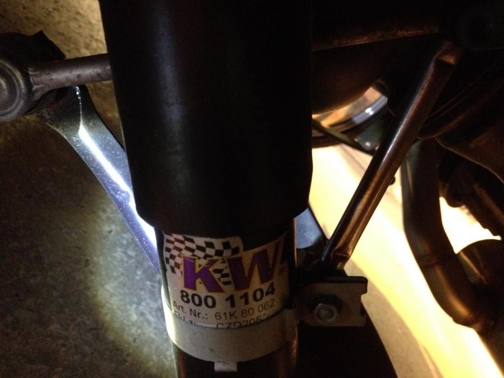

I took this today while I was refitting the wing liners if you still need the part number.

Cheers Matt. Ed was hoping that lower number was more visible but said not to worry, they will sort it when it goes to them next.

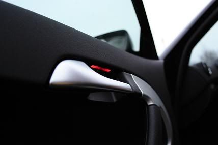

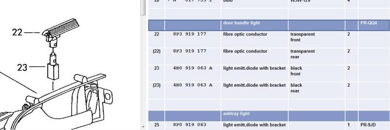

I've just ordered some Audi door handle LEDs (Bigharty's fault!) which means another project when it comes back from Reflex! I suspect I'm going to get stuck with the wiring but it should be straightforward enough - I'm assuming take a feed from the one of the interior lights that come on when you remove the ignition key? On the Audi forums where I found the pics they also mention +ve for the door handle illumination lamp on the 32 pin connector is pin 17. -ve is pin 19.
Its possible I may have ordered 2 sets of 2 as opposed to 2 individual parts but still only £25.
As mentioned in Bigharty's thread, the part numbers are:
8P3 919 177 - led diffuser
4B0 919 063 A - led module
Subtle effect at night
