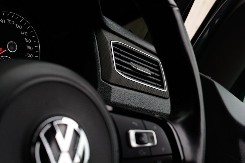

Picked up Caddy Life Dash Vents in the cyclone (grey). I wrapped them in the 3M Matrix Black vinyl wrap to see how it would look, the plan was to have them sprayed pure grey but now I'm undecided.
- Lister79
- Posts: 2133
- Location: Lake District
I like the wrap mate, I’d personally leave them wrapped.
- Posts: 896
- Location: Ireland Dublin
The other piece didn't turn out as good . More wrap on the way
- Posts: 896
Finished off the Caddy Life dash vent trims today, the longer one was a pain, took me 5 attempts. I ended up separating the vents from the face so I could finish the wrap off nicely around the actual vent. Glued it back together with some Tiger Seal and used my old soldering iron to do a bit of plastic welding. The old vents popped out easy with a trim removal tool.
