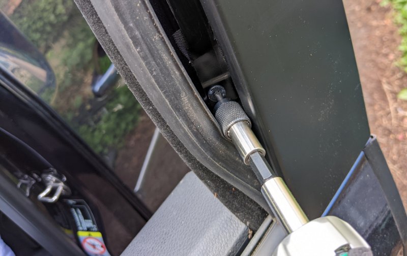

Do you have any pics? I was thinking of doing mine, but the only guide i could find, was for a golf, and it slots under window scraper seal, which required manipulation, as the trim slides down into door, next to glass. I wasn't keen on this.
Does the caddy trim, just unscrew and lift off?
Posts: 2300
Re: Too flashy ?

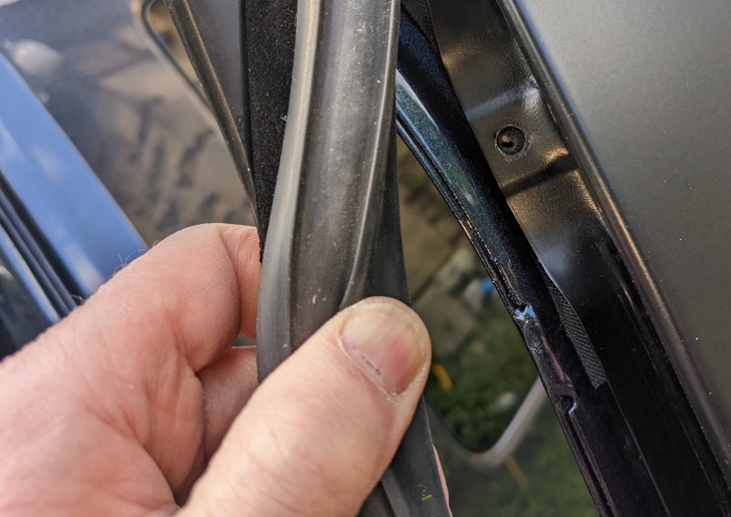

Super easy.
Drop the window.
Pull the rubber seal forwards to reveal 2 Philips head screws.
Remove screws.
Pull trim backwards (door open).
Left hand door.

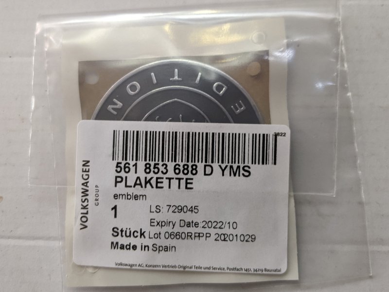

Where can you buy this symbol or other type of symbol?
Posts: 2300
Re: Too flashy ?
Hi,
Wolfsburg EDITION badge is a genuine VW part from LLLParts.co.uk
561 853 688 D YMS
They are also available from AliExpress but I think they may be copies ! Some definitely are.
