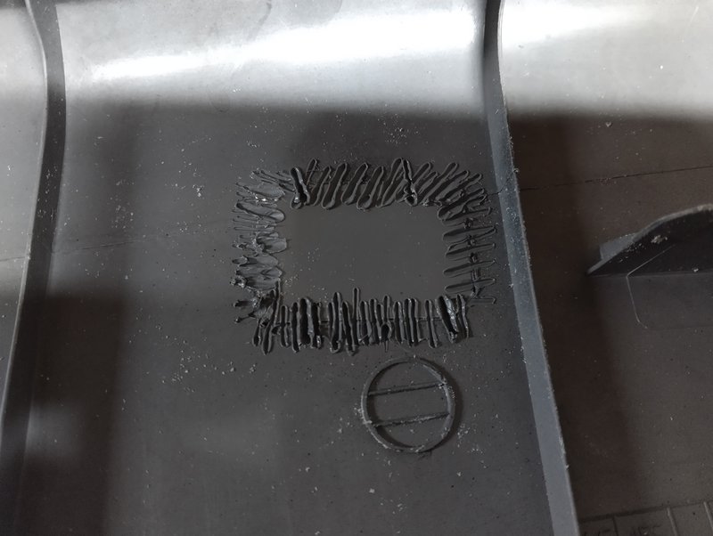

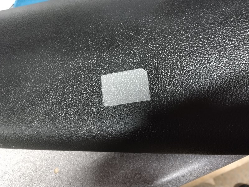

Couldn't get any takers for the Caddy Life carpets that I picked up from a scrap yard and had decided to eBay. With the prospect of binning them, I had nothing to lose by cutting them up to see if they would fit. With a bit of effort got them in. Also fitted the freshly painted trim delete panels that came from the same Life.
Already painted the lower B trim panel and then patched in the hole that had the alarm switch on
