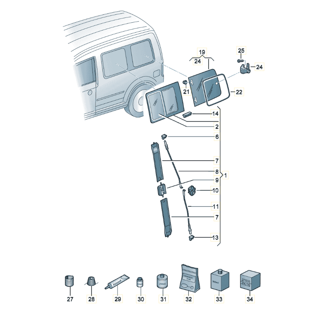

My 2010 Maxi life has a water leak from the sliding window in the sliding door. There is a rubber seal on the sliding part of the window that appears to be intact but i guess needs replacing. I cant find the rubber seal as a seperate part and I fear that the whole bonded glass with the sliding window will be one part. Has anyone got a simple fix? Please!

There was a similar issue in this thread viewtopic.php?t=51548 although he resolved it by bonding the glass so it was fixed rather than sliding.
I can't see that the rubber seal is a separate or service item. The sliding part is though - #2 in this image. The Maxi one is £150 from VW and that might also need VAT adding to it. The entire glass panel #1 is £595.
Might be worth talking to vw parts dept as they can quote based on your chassis number so you would get the correct colour. I doubt autoglass sell these but its another option to see if they do and whether its cheaper.

Thanks Dan.
That the pic I'd found. I need to phone VW.....

Hi Duncdan,
mine is leaking because seal in sliding windows is too flat, because of age. I found on eb*y seal which is bigger than that (cost £50). That is one solution, but I put double-sided tape (2mm), under seal and now no more leaks (20 minutes £0), now windows closing harder because seals are "bigger", but no leaks

I experienced a similar problem with a 2019 Transporter Kombi I had. The VW OEM drain was notorious to fail and leak inside the van. Looks kinda similar to the exploded diagram here. Ended up replacing with aftermarket windows with a simpler external drain. There were lots of people who had tried to fix themselves but it always ended up leaking again.

If you see the diagram early in the thread it shows the inner sliding glass has a rubber seal that flattens over time. The suggestion is to remove the rubber and refix it with double sided tape to add some thickness.

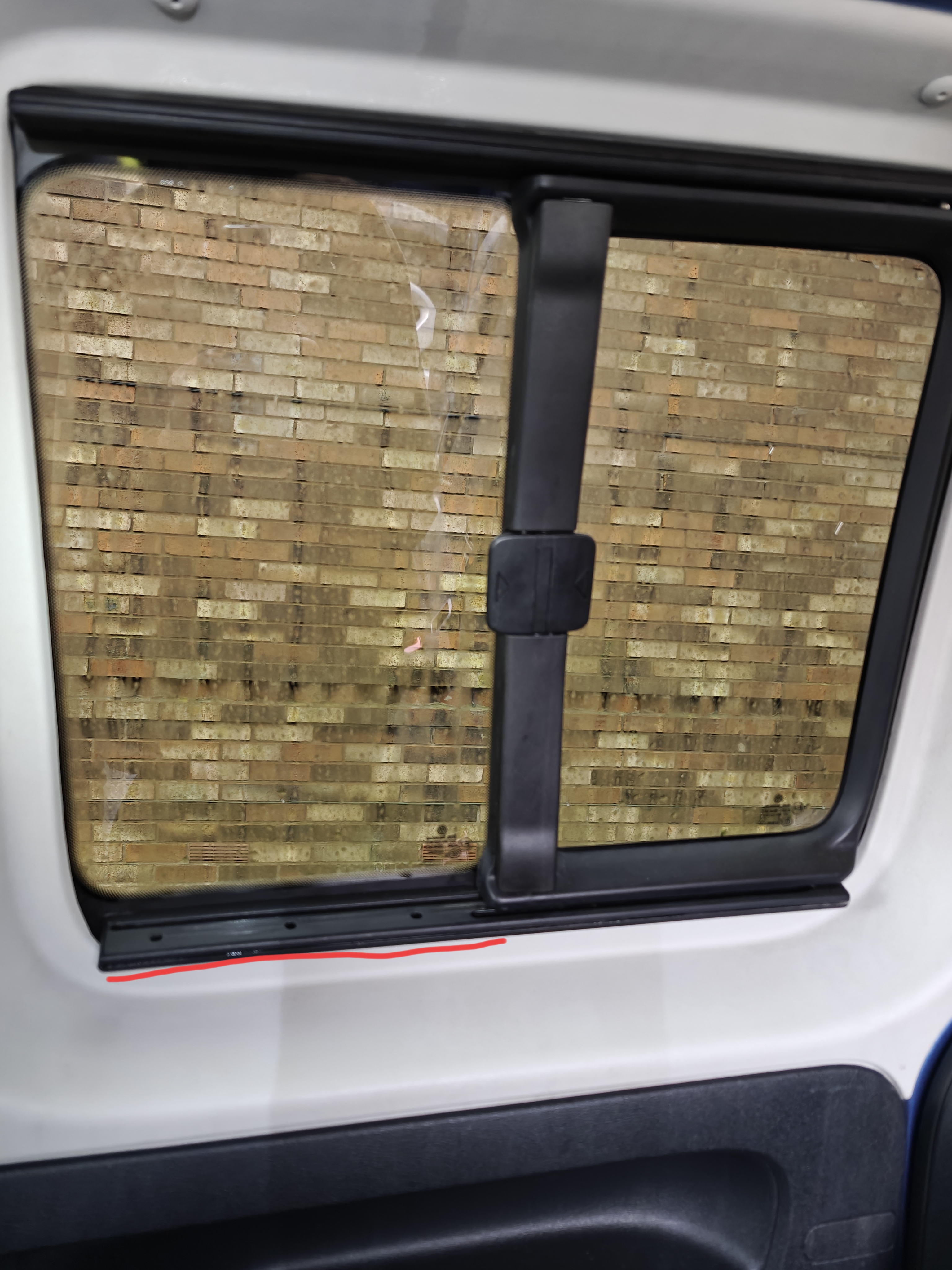

I've just been looking for threads about this issue as my 2019 Caddy Maxi Life has a sliding rear window that appears to be leaking. I noticed this recently but have not had time to take a real close look. When I did quickly look the other day I couldn't really see how or where the water could be getting in from and I couldn't see any rubber seals at all.
I know this thread was started by someone with a 2010 Maxi Life, so has anyone had this issue on a Mk4 Maxi Life and better still know how to fix it?
Picture below shows where the water can be seen inside the car. It's not pouring in or even dripping but I can clearly see that water is collecting where I can marked the picture in red.
