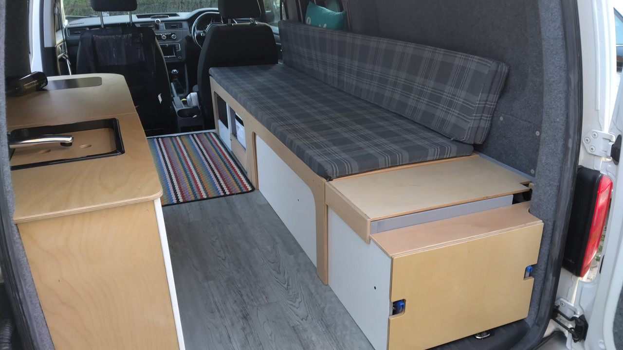

Access panel for the storage in the pull out draw for when the back door is closed.
There are times when you just don't want to have to open the doors to get at stuff.

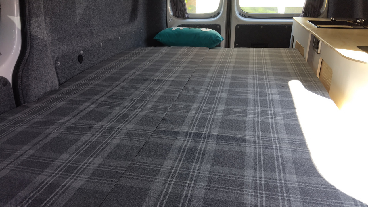

This shows the bed pulled out. I could have just extended the bed but it's already 1800mm so should be plenty long enough. I did think of extending it but the space at the end of the van means that you can get at the barn door latch and out of the back with the bed pulled out.

View from sliding door. I've added the supporting legs.
Unfortunately the screws are visible but it was the only way to make the legs strong enough.
Full width of bed is 1100mm. For the Caddy not bad. The VW California's bed for comparison is 1160mm

2x 40mm x 1800mm x 550mm firm foam
Bed size is 1100mm wide

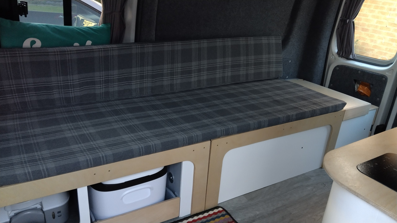

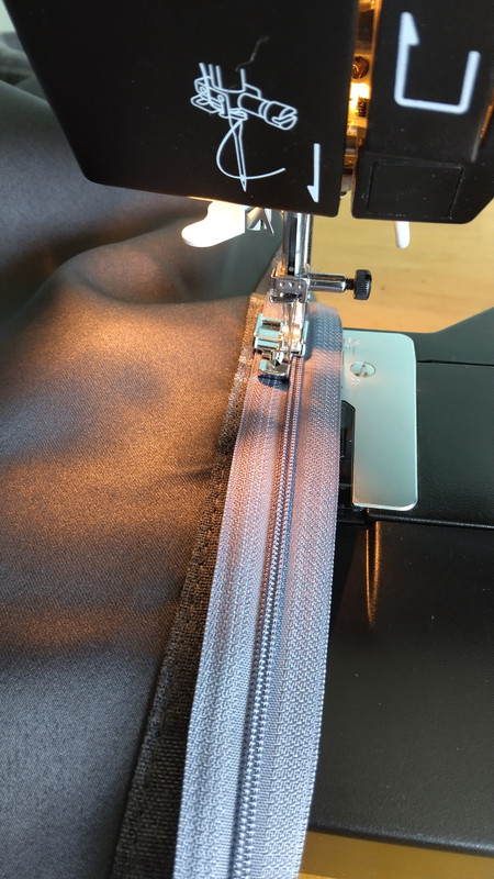

The cushion covers are one of the most challenging things I have made for this project.
Made three covers, which were then sewn together to form one concertina cushion. This is so that the gaps in the cushions don't slip when the bed is used. The end cushion has velcro to hold it in place.
Though this is definitely more work it is comfortable and works well.

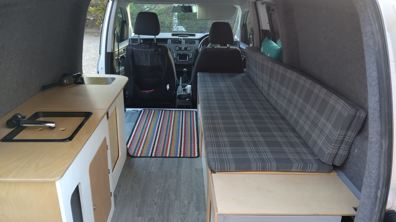

This was a difficult build because of all the things I wanted to get from the bed section.
Pleased mostly how it's turned out. Campervans are always a compromise between space and function and the Caddy makes this even harder as it's a small van.
