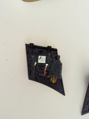

Pictures attached to help understand the above.
these pictures show the tweeter backplate removed, the vibe tweeter surround glued backward (face up) on the tweeter housing, and the finished articles with the new tweeter, mounting ring and factory connector all glued together, with the inline capacitor and wires wrapped in fabric.

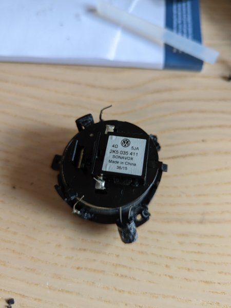

other pics. these are the factory tweeter before and after removal from the housing

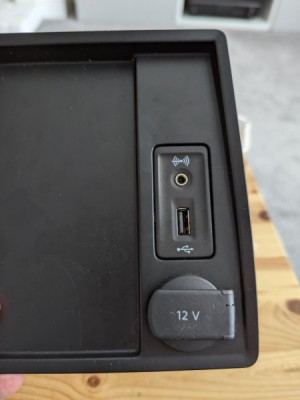

swapped the cig lighter for a powered USB with switch.
