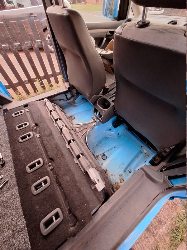

Now that my leaks are sorted I finally got around to stripping all of the rust from the floor pan behind the passenger seat. I was surprised by how deep the pitting was in some places. I stripped all visible rust using clean and strip discs and wire brushes then treated it all with kurust, before painting in two layers of rust inhibiting primer. I'll topcoat in a couple of layers of LL7E Flannel Grey this week now that the evenings are bright again.
Before
After
