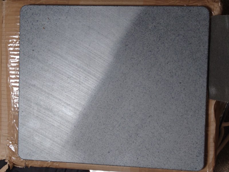

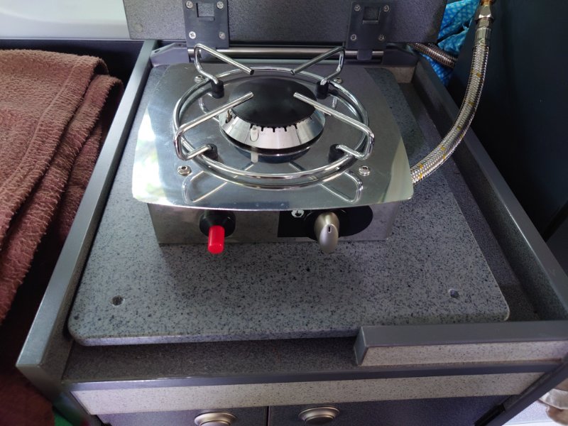

Got a new HDPE board to mount my cooker burner on.
Chose a nice Grey Granite board to sort of match the rest of the fittings.
When it arrived I was a little disappointed as it was a bit scratched and had obvious shiny production tool marks :(

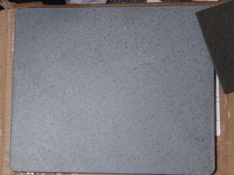

Luckily - A quick rub down with a grey Scotchbrite pad and it looks much better
Half way ...Old vs New finish
Finished - Faces and edges.

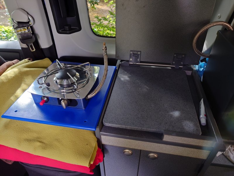

Better check it fits now !
Phew 😅
Looks nicer than the blue one, though functionally no different.
Just got to drill a few holes now ...
Posts: 2302
Re: Starlight Blue Caddy Life - Mk4 2K SA - WAV + Stealth Camper for One.

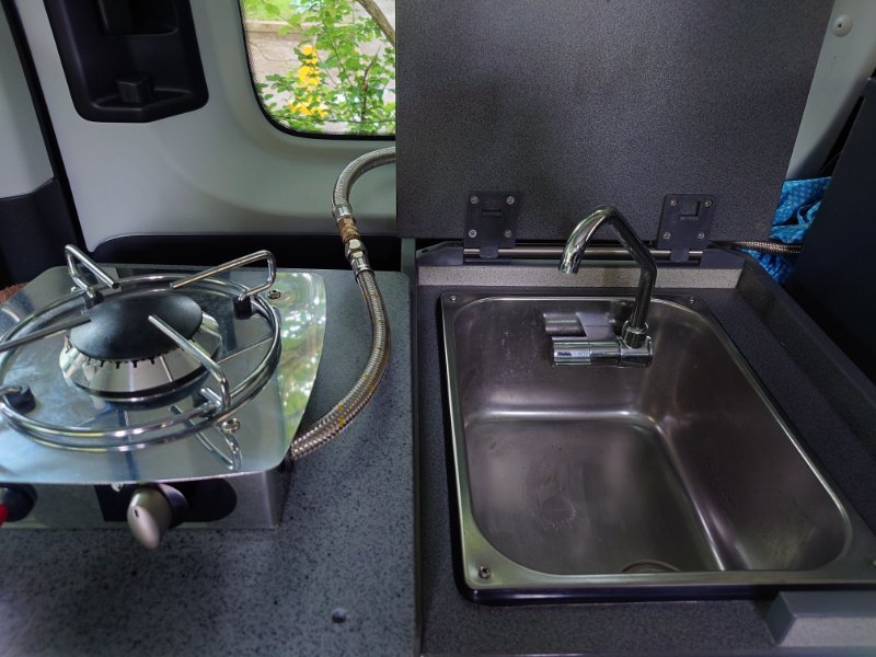

Fitted the new Granite Grey board ...
Decided to fully disassemble and mount the burner unit using blind holes instead of through bolts.
Chopped a tiny bit of the end of 4 SS screws so that they don't go straight through the board
Top side (work side) with the four locating points showing (not through holes)
Cooker neatly stowed in the sink
Flipped to cook position
Posts: 2302
There's enough gas hose to do side by side mode too

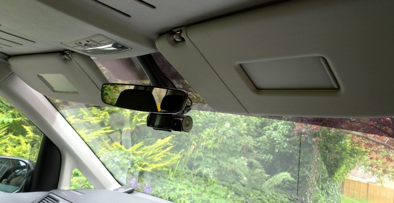

Finally !
Got rid of the stupid baby seat warnings from my LHS sun visor
:D
And relax.
Ahh.

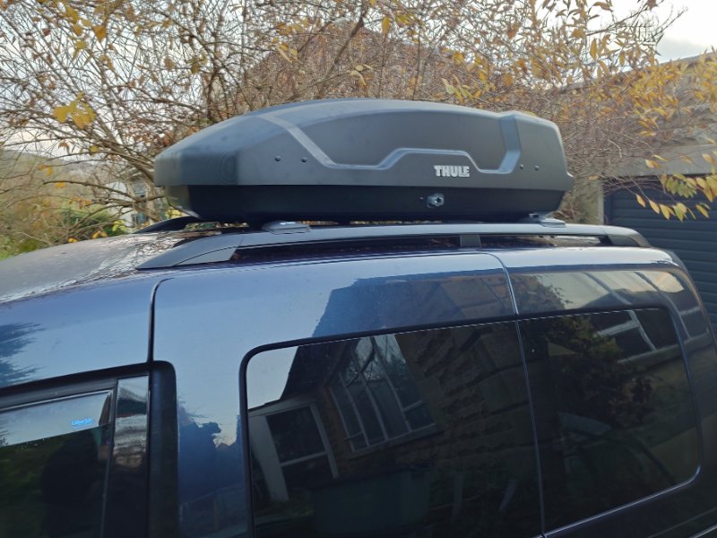

Fitted new fuel economy upgrade Aero Box - THULE Force XT Small Roof Box on Turtle Low Level Crossbars !!
Actually works - Improves MPG (improbably)
Just like the Aero-Bag for Cyclists !
