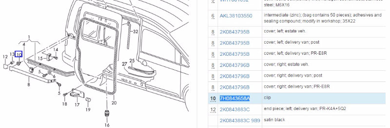

i cut and bent some steel (around 2-3mm thick) you need to bend it into a L - V Shape then i used the original back clip and a blob of adhesive, took me about an hour to perfect it but saved me monies :D i bought my rail from the local VW dealer :oops: , think it was £43
2K0843795B Left Rail Cover
2K0843796B Right Rail Cover
7H0843658A Clip For back End of Rail

Ash08 wrote:i cut and bent some steel (around 2-3mm thick) you need to bend it into a L - V Shape then i used the original back clip and a blob of adhesive, took me about an hour to perfect it but saved me monies :D i bought my rail from the local VW dealer :oops: , think it was £43
