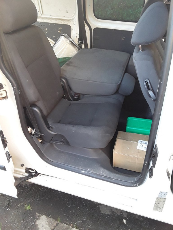

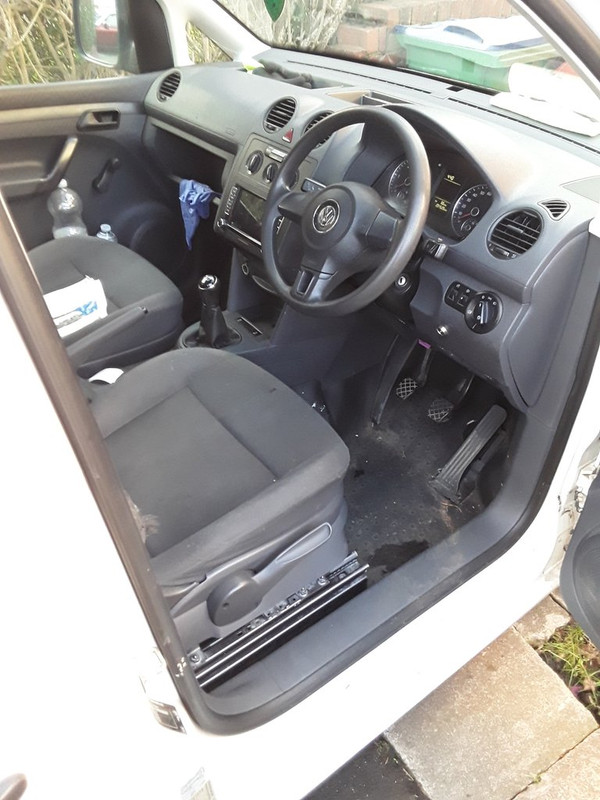

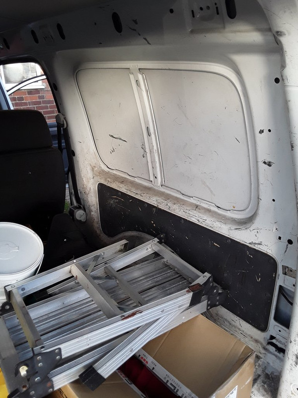

The interior, this van has definitely been used!
Comfortable enough though, i have already done 1K miles in it.

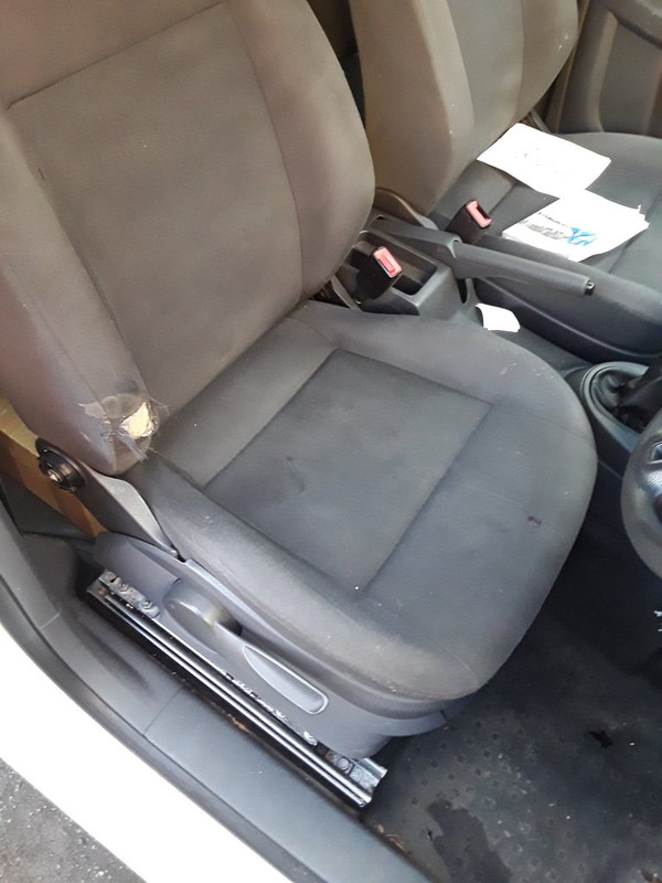

Back seats in decent working order, dirty as you like but working.
i think I'm going to need thinners or something to clean this up

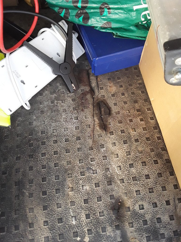

Floor is in a bit of a state, id like a replacement but id imaging they are not cheap / hens teeth
as you can see it is a work van. not real work, IT stuff

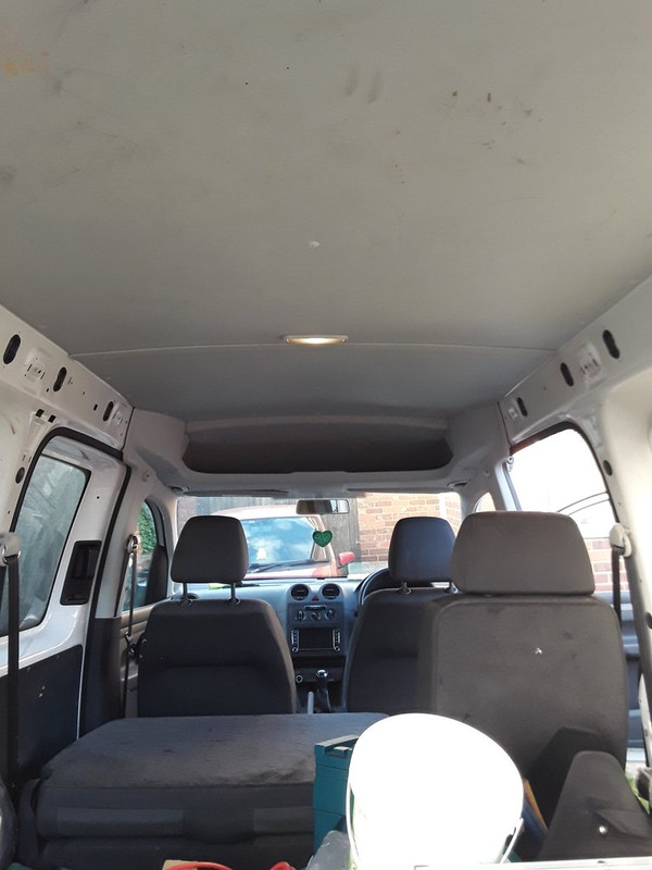

headlining in decent order, i would like to wrap it in stretchy carpet stuff tho
steel wheels! jealous much? i do have the centre caps though so thats something? maybe?

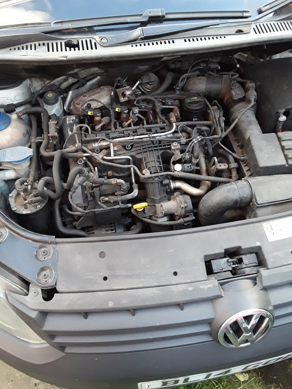

A lot of miles on it. engine runs surprisingly sweet though.

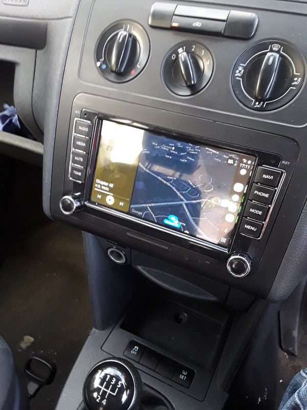

upgraded the stereo with a £45 ebay jobby, the one in it didnt work at all.
1.6 litres, count em!

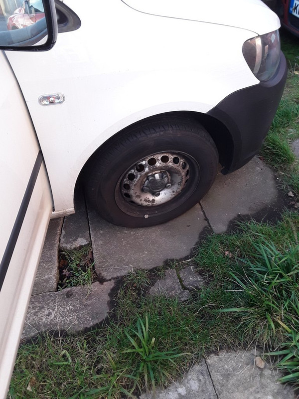

I also hit a ripped to pieces truck tyre on the M6 last week and one of the front bearings is grumbling really loud at25 MPH and onward so don't want to risk it on the road again until that's done.

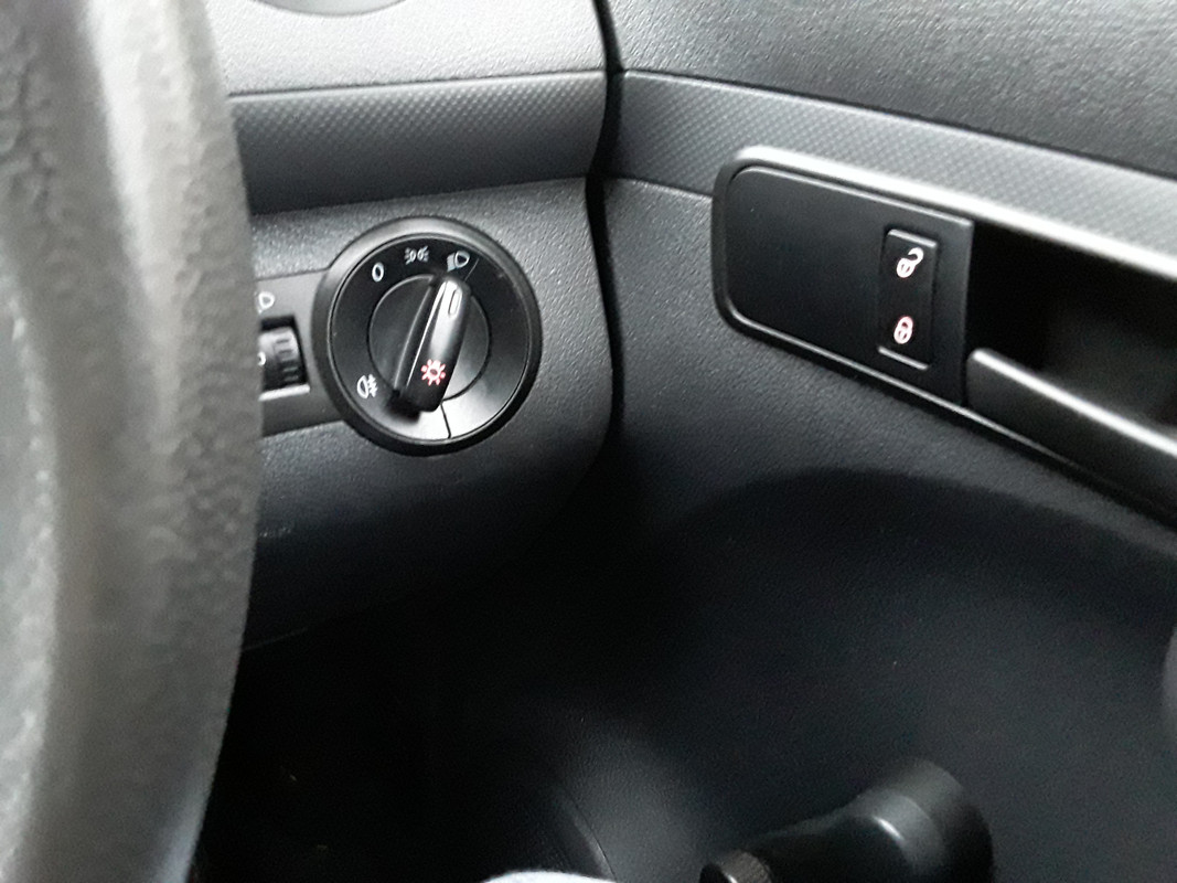

The side lights are on permanently, but then when you turn the side lights on they go a bit dimmer, does that mean i have daylight running lights?

Wipers will switch to intermittent when you come to a stop
Sidelight is actually a DRL and yes will dim when main beam turned on , it has a stop and tail bulb in it,
The lights will switch off after you lock the van , coming home is activated in the BCM,
There’s other things can be activated like if you unlock it but don’t open any doors it will re lock itself, rear wiper activation when in reverse to name a couple

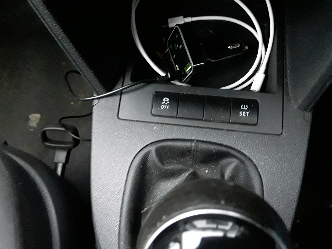

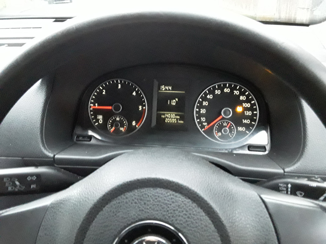

The next odd thing (fault, issue?) i have going on is since i hit that truck tyre i have had this warning light appear:
If i press the presumably corresponding button:
Then it just flashes and not a lot else. Now if I've read correctly then its a tyre pressure monitor. My question is how does it work and how can i sort the warning light? oddly i got the info off the internet, there's no such light according to the manual.

Turns out a long press on the Tyre pressure sensor button resets it.
Glad of that, i don't like looking at warning lights on a dashboard.
