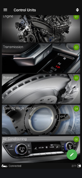

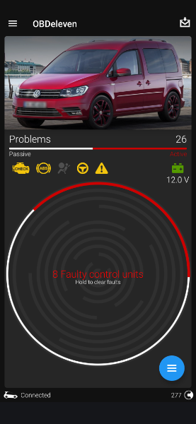

Good evening all, I have an ABS light illuminated and my MOT is due soon. Using OBDeleven I get the following code: 01276 intermittent.Image[/img]
I have disconnected the plug and would like to at least do some basic checks in there to at least see if I am getting any power in there and maybe check grounds etc. Is anyone familiar with the wiring on this model, who can offer any guidance on where I can test and what voltage values I could expect to see on some of the conductors/colours?
It’s a 2009 1.9tdi lbs if that makes any difference. I have taken a couple of photos, hopefully they may be of some help.
