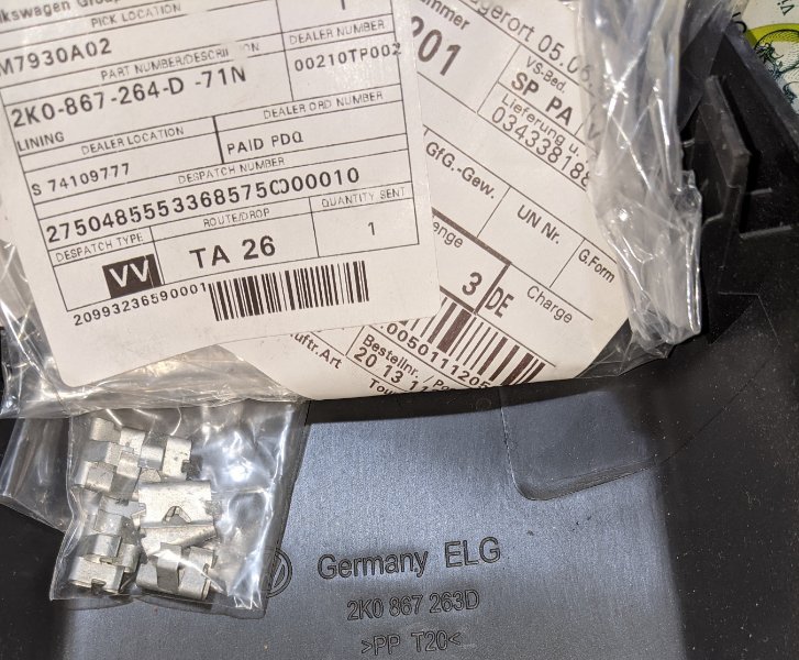

Covers
2K0 867 263 D 71N
2K0 867 264 D 71N
Also need the 4 little clips for each cover

My drivers side seat belt is hidden, the passenger side I purchased a cover as mentioned above 👍

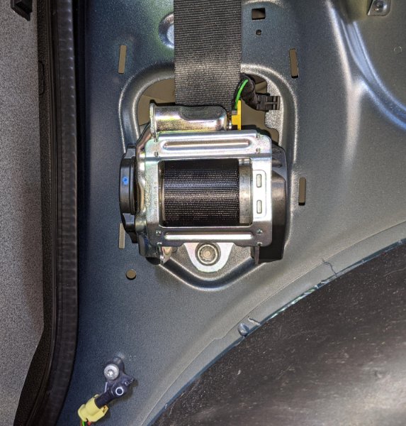

Posts: 2292
Re: Rear seat belt fitting
Fitted
Bolt at the bottom.
Your pic shows mounting hole at bottom, horizontal T-slot fits the plate on the reel, four vertical slots are for the cover.
Sent from my Pixel 3a using Tapatalk

petrev wrote: Tue May 25, 2021 8:23 pm Fitted
Bolt at the bottom.
Has there been an alteration to the mounting bolt on this pic? The ones I've got look like it's bolted from the back. Can anyone shed some light on what to do so that my touran seatbelt cartridge can be mounted on the front of the C pillar rather than cutting like in some YouTube videos 🙄

Posts: 2292
Hi,
Standard fitting is on the outside
There needs to be a "nut" added if not provided by VW.
I think an M10 steel Rivnut would work, though some might prefer a genuine seatbelt spreader plate with 7/16th UNF threaded nut !?
Mustn't block the T hole.
