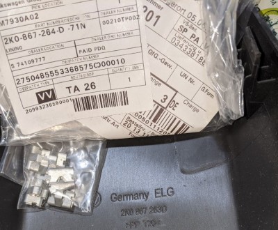

Covers
2K0 867 263 D 71N
2K0 867 264 D 71N
Also need the 4 little clips for each cover
2K0 867 263 D 71N
2K0 867 264 D 71N

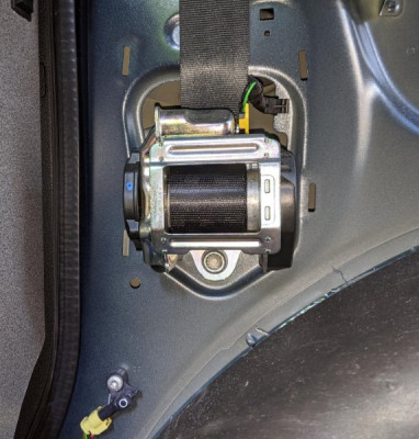

Re: Rear seat belt fitting
Fitted
Bolt at the bottom.
Your pic shows mounting hole at bottom, horizontal T-slot fits the plate on the reel, four vertical slots are for the cover.
Sent from my Pixel 3a using Tapatalk
Bolt at the bottom.

Hi,
Standard fitting is on the outside
There needs to be a "nut" added if not provided by VW.
I think an M10 steel Rivnut would work, though some might prefer a genuine seatbelt spreader plate with 7/16th UNF threaded nut !?
Mustn't block the T hole.
