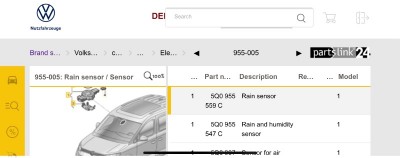

Yes the rain sensor and humidity sensor fit in the housing 5Q0955559C which is the same as the golf one, TPS sent me the exploded diagram, mine has the space for it but has an in fill part sat in there, I am doing more work on it today so if i get time i will pop it open with the trim tool.

And have they confirmed that that sensor will work? I’ve got 2 different part numbers for the new caddy.
So far I’ve discovered the van has a humidity sensor behind the rear view, and that Volkswagen customer services are crap!
The auto lights appear to be done through the sunlight sensor at the base of the windscreen, but it’s control of the lights is crap at best!
