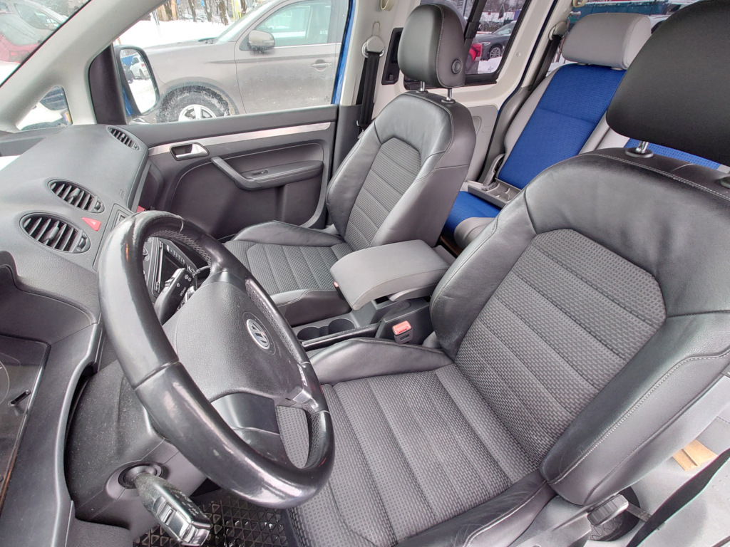

Slowly getting there with my anthracite front part of the interior idea. Yesterday, I wired in the ergoActive seat electronics (admittedly, I do enjoy the massage with back heating) and mk7 airbag plugs. Interesting to note that the heating on the passenger seat works fully (backrest and buns) with my old wiring loom yet that's not the case with the driver's seat which just has the back heat up.
Today, I fitted a black leather Touran passenger door card with a warning light. Not fun cutting it up with a mini angle grinder to fit the Caddy, but the result is worth it. Working on the driver's side door card now and praying for some non-terrible weather and daylight to fit it.
How easy were they to wire in?
I was offered a pair of ergoComfort seats from Passat today for a reasonable price. They are quite tempting. But only if I can get them to work as intended.

Thanks. Relatively easy as mine is a manual seat with electric lumbar support. The module under driver's seat just needed 12V (pin no. 1 in a 2015 Golf mk7 floor connector) and a ground (pin no. 5). I ran a 1.0 mm thick wire to a free slot in the interior fuse box and the ground to the grounding point at the door sill. AFAIK, many ErgoComfort seats are fully electric with a memory function so they have to talk to the BCM which is much more complicated. If you have prior experience adding pins to the CECM/BCM and fuse box, coding in VCDS, then you should be fine.
