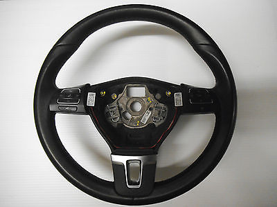

Put a cheeky £40 best offer on this, expecting to get rejected, but won it, glad,but gutted,as also put a offer in for a complete mk4 steering wheel and air bag and won that too, bugger
Hope it fits!!, need to pull the surrounds down and check these module numbers, :roll:
Any one know what the buttons do can't make it out from the piccy, :oops:

nice wheel, if you dont want it i would take it off your hands for the daughters polo :D

Any one know if the preface lift caddy (mk5???) air bag will fit? Can't find any pics of the different styles to see if I need a new air bag or my caddy one will fit
Thanks
