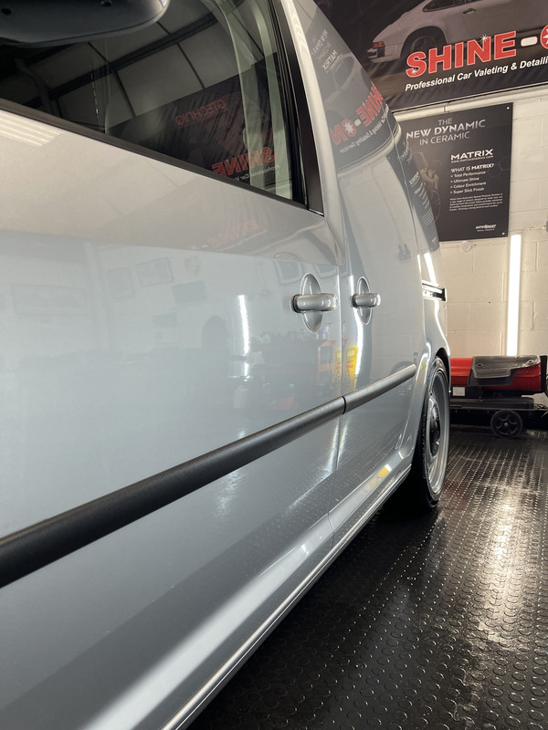

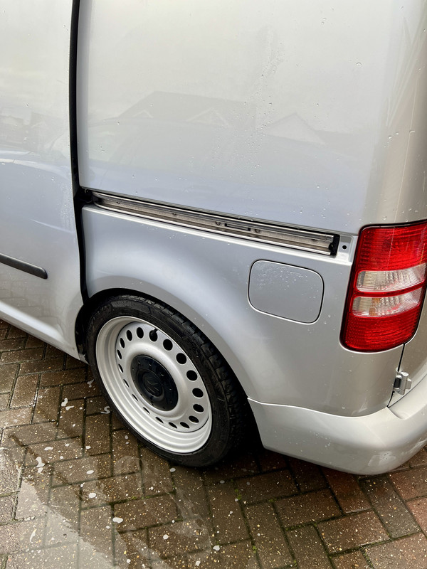

My first mod was a new side door rail and rail cover from Reflex Auto Design 😁
Only issue I had was the how to videos I watch said it was a Torx T25 or a 4mm hex (Allan) key. However it was not it was XZN or multi spline so a trip out for new tools was required 🙄

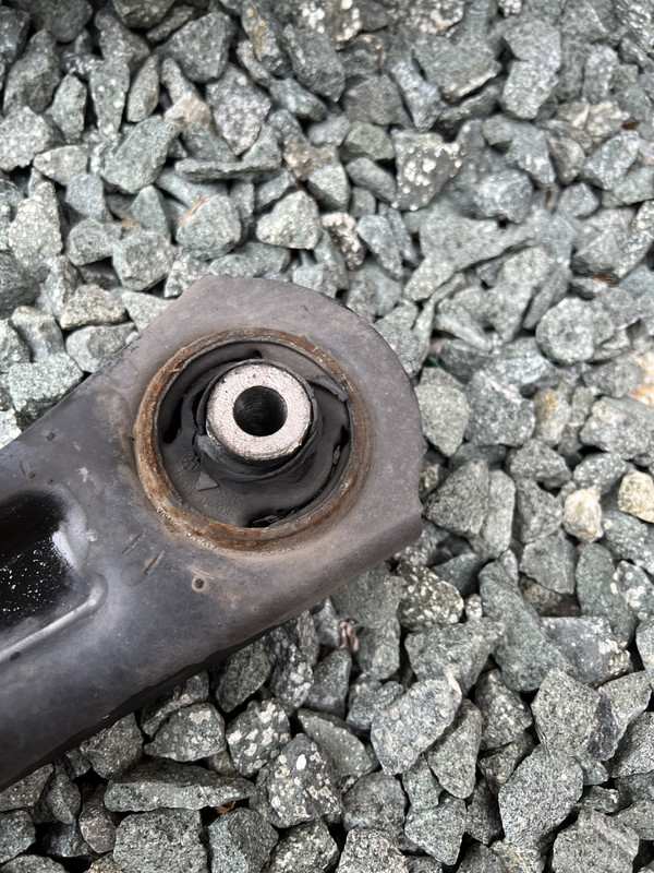

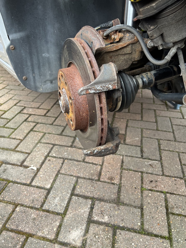

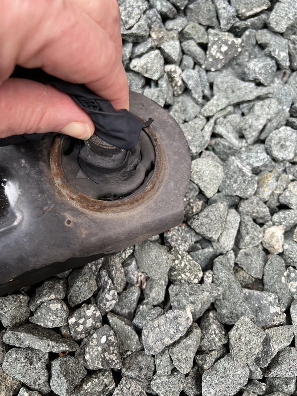

This week was MOT time, I did give the van a look over and spent quite a bit of time cleaning under the arches. However I didn‘t look at the front wishbone bushes which is what it failed on 🙄
So new wishbones and ball joints fitted and then it passed its retest with flying colours 😁

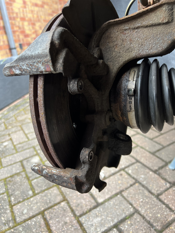

However one thing I noted while getting know my van more intimately is something I‘ve never seen before…. The caliper carriers were part of the hub and not a bolt on part 🤔 This now means I’m going to have to replace my hubs to carry out my 350mm 4 pot brake upgrade 🙁
I know from talking to others that not all caddy’s hubs are like mine, the question is is there a benefit to upgrading to mk5 Golf GTI hubs over Caddy hubs (non integral carrier type)?

Re: Nath‘s Reflex Silver 1.6TDI Match
Those hubs only come on the lower powered Caddys with the smaller front brakes.
Mk5 GTI front hubs are exactly the same part as is found on the Caddy with the removable calliper carrier so don't go paying a premium for GTI specific parts.
