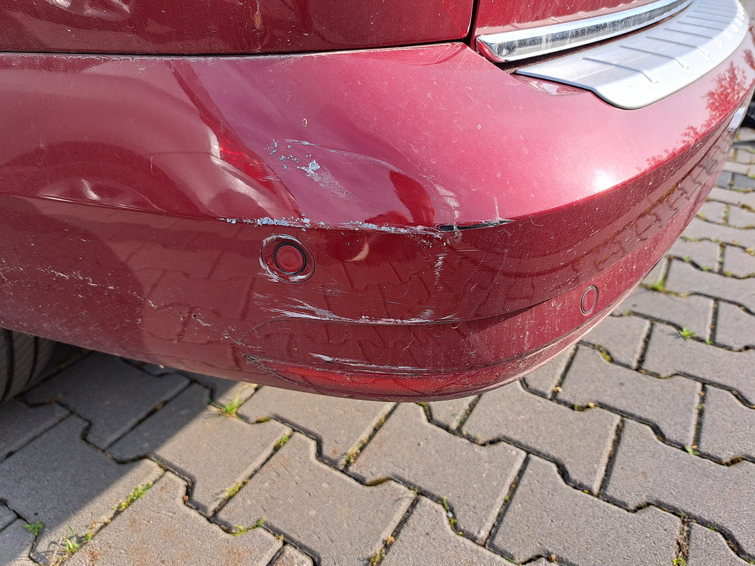

Our Caddy received its first scratches yesterday. And it was not out fault.
I noticed it when I got to the car, leaving work. Rear bumper was clearly touched. So I checked the car standing next to me, and it was apparently guilty. So I left passive aggressive note behind his wiper and indeed in the evening got a call.
You would not guess that - the guy did not notice anything (that seems strange to me, there was a lot of space between us), was pretty nervous and told me this was his second drive. He might be lying, but I think he was not. The car even had "beginner" label on it. So while I was pretty pissed, I could not be mad at him. I checked if the parking sensor works, it seems to be OK, and when I cleaned off most of his shitty paintwork, it is not too visible, so I just left it be.
The parking lot was half empty though. That is also why I did not care too much about my alignment. He could have just parked 10m farther from the entrance where there was literally no one, just tumbleweeds rolling across the parking lot. It is what it is.

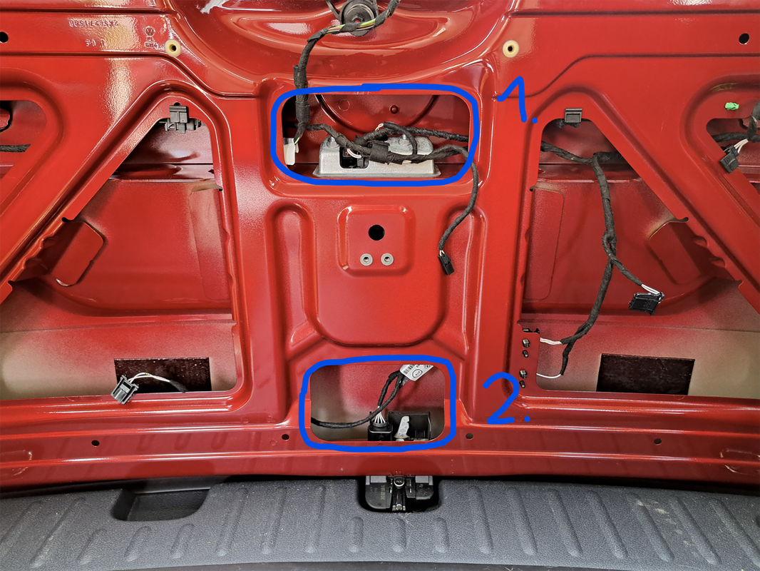

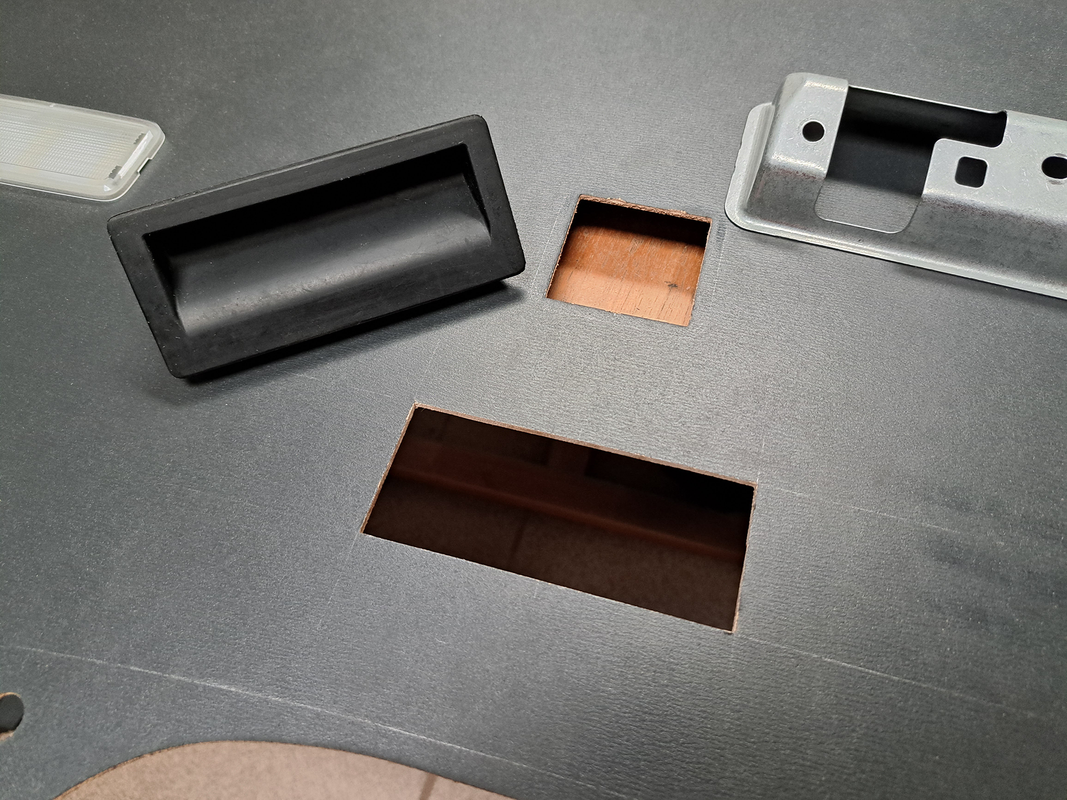

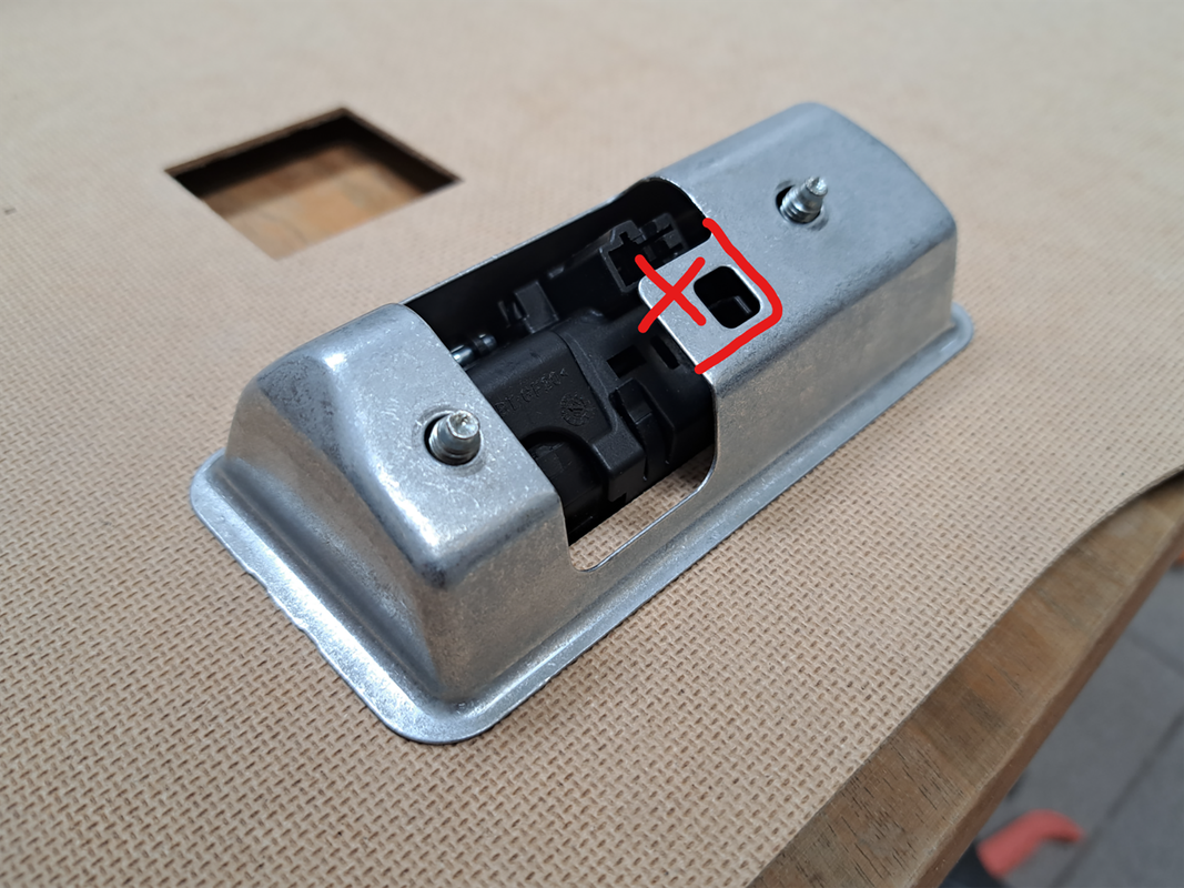

Since I am not allowed to classified forum sections, I will post a little info on a tiny "project" I did. So...
Tailgate opening from the inside
Since we intended to sleep in the car, we realized it might be annoying not to have the possibility of opening the tailgate from the inside, so I started thinking what to do with it.

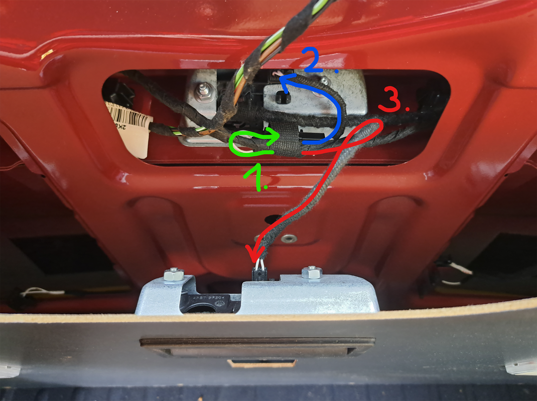

In juliang’s Acapulco thread I saw a pic of the tailgate stripped where it was visible that only two wires lead to the opening button. Did a little research and it turns out that the opening button apparently just serves to connect a wire and that signal unlocks the tailgate. Plan was clear - add one more button to unlock the door on the inner side of the door.
Provided you want to place the opening button in the middle of the door, there are two potential locations - (1) above the “bus handle” and (2) below it.

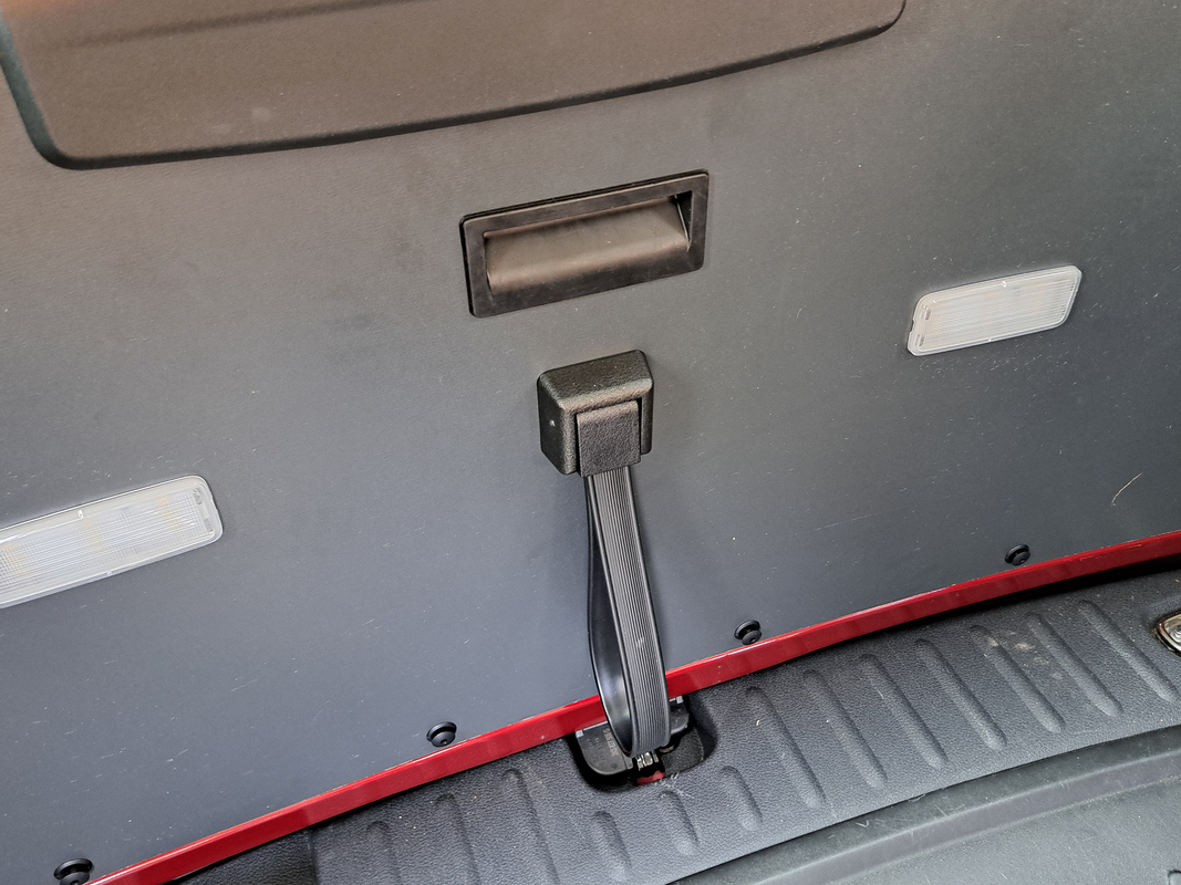

I decided to place it above, very close to the outer opening button. You do not have to push that far and the button will be more accessible even if we had some kind of elevated bed inside of the car. The ”bus handle” won’t hang over it. On the other hand, when placed close to the floor, there is more space inside of the door. The location I picked already has the original button in there with some cables. Lower location is totally empty inside the door.

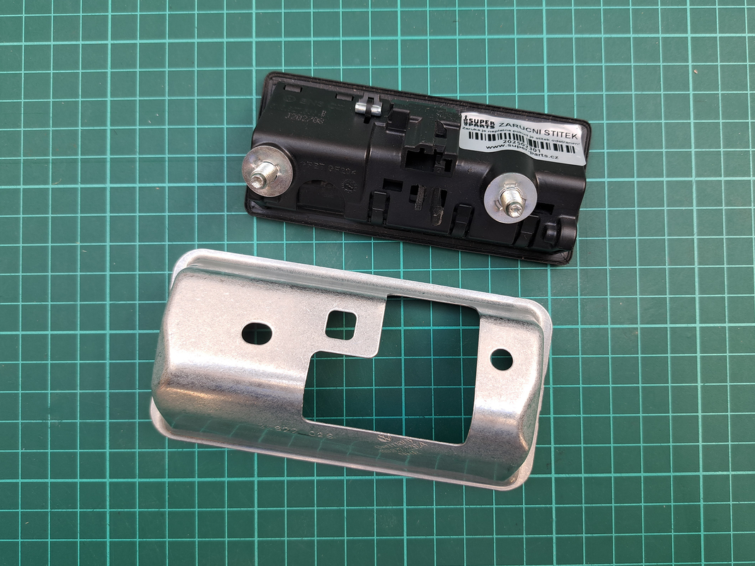

I bought original opening button 5N0827566T and metal housing 1T0827229A

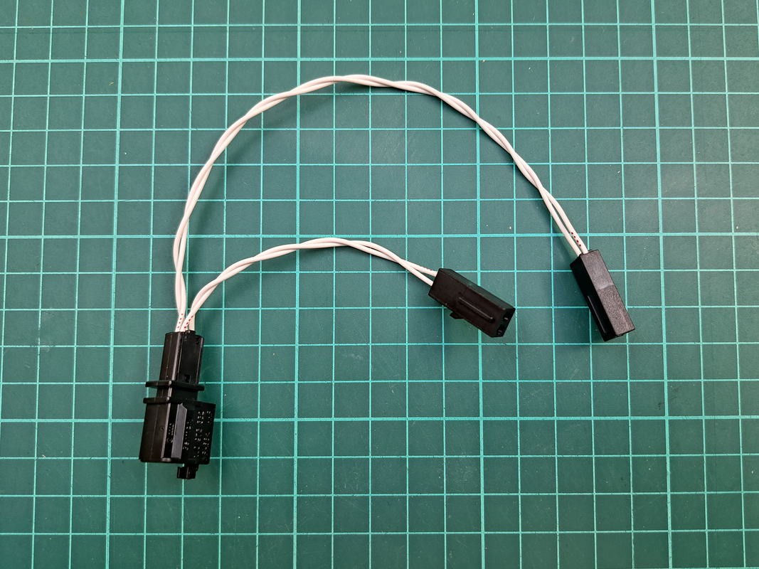

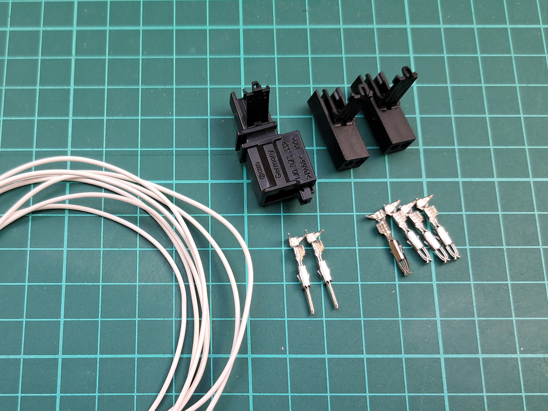

I did not want to interrupt the original loom of the car, so I decided to make myself a spliced “wire extender”.
After opening the tailgate I checked the connector part number and bought some more of them from our Chinese fkin friends from AliExpress, because originals from VW parts dealer were scandalously expensive for a piece of plastic.
Male connector is 1J0973119 and female 1J0973332. When buying the parts from Ali, do not buy the connectors with wire already in, it is too thick. Instead just get 0,5mm2 wire, because crimp terminals provided with connectors can take two of those, so you can just splice it without any issues.
I bought here https://www.aliexpress.com/item/1005007 ... 19cM6g8ls (the link will probably get outdated someday)
I made one end 10cm long and the end going to a new button 20cm, so that I can remove it comfortably when disassembling the door cover. Finally wrapped it with a textile tape.

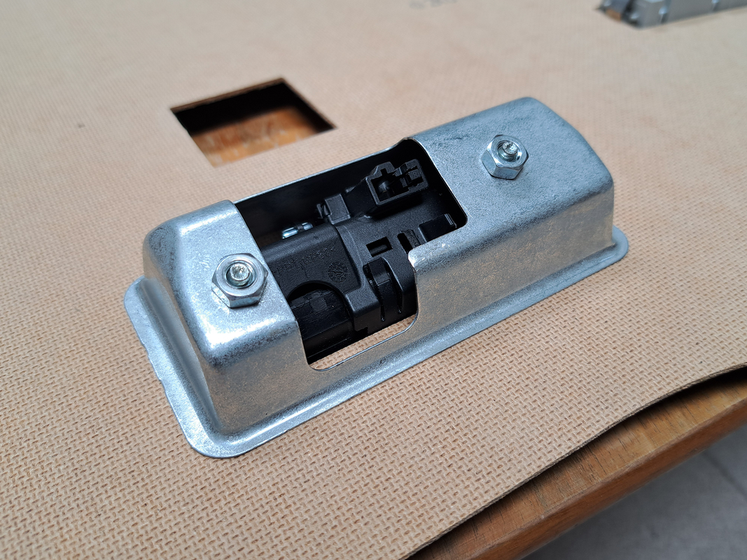

Then I was fiddling around with exact location in order to avoid interference with already placed cabling and outer handle. In the end I placed the button exactly in the middle between wiper cover and the “bus handle”.
Took the door cover and cut a hole exactly 42x101 mm. I made it slightly smaller and then was filing it so that the button sits snug. This is not necessary though, since the metal housing should hold it in place.
A little issue arised. The door cover is thicker than metal, what I expected, but the outer button placement apparently has a few mms offset inwards (is not mounted into planar sheet of metal, but there is an indentation around it), so the metal housing was not fitting perfectly, in fact interfering with the connector, so I had to cut a bit off.
Now it is easy to pull the connector out. Furthermore, as you can see, the two threads are a little too short, but I think it will work. A little Loctite thread locker could maybe help. It was finally time to put it back into the car.
Connector labelled as (1) did previously go into the outer button. Instead I connected my extender to it, shorter end of extender (2) goes to outer button and longer end (3) to the inner button.
I also moved moved the wiper cable holder out of the way to the left. Untaped it from the cables and retaped it elsewhere.
Now it looks as if it belonged there, doesn’t it? :D

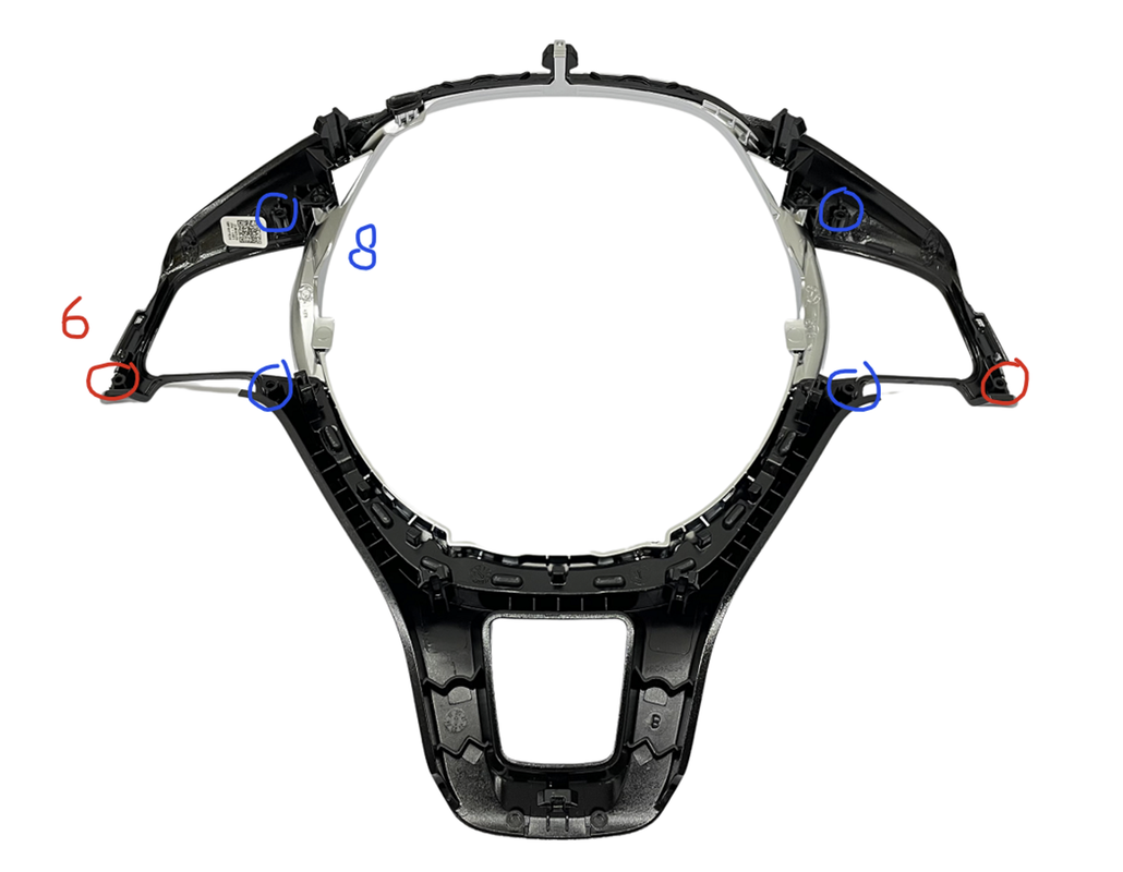

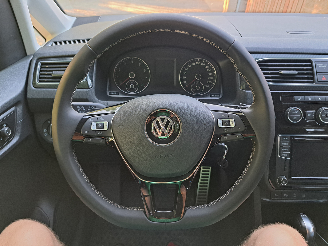

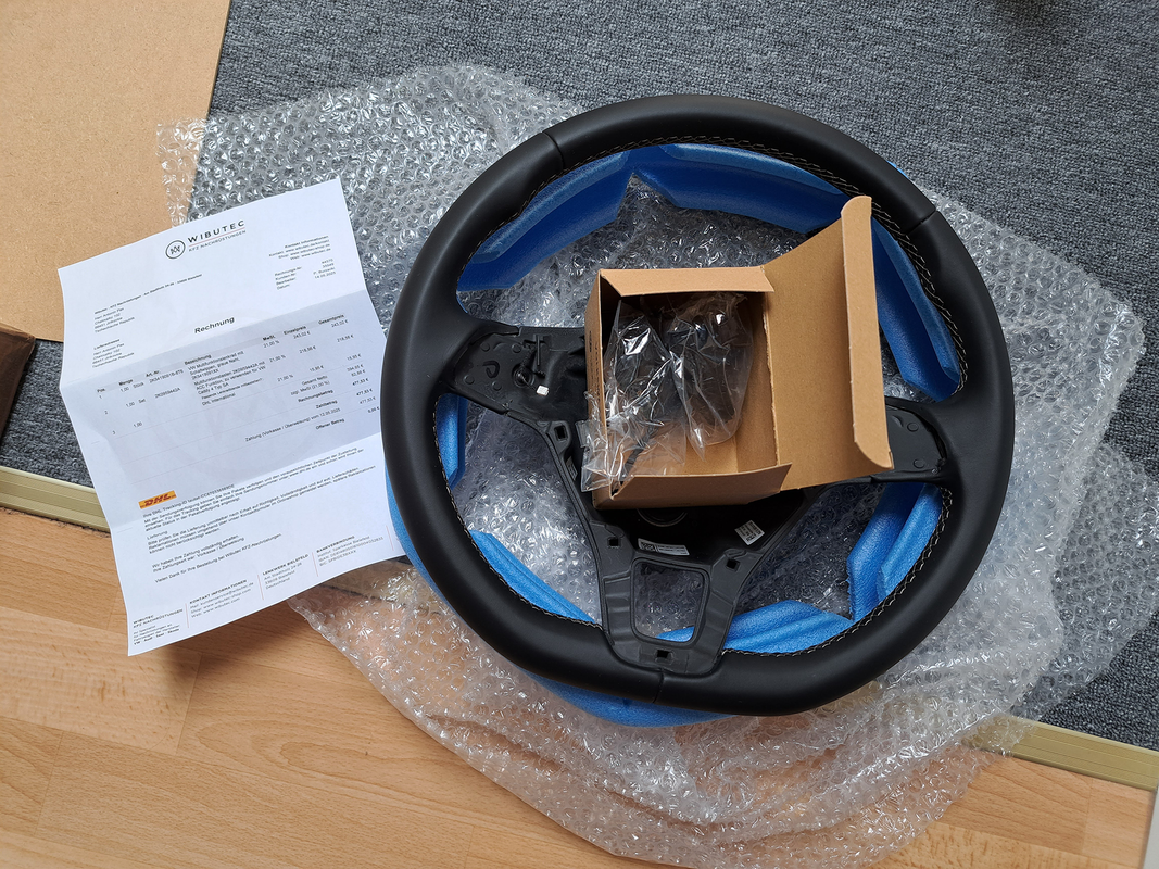

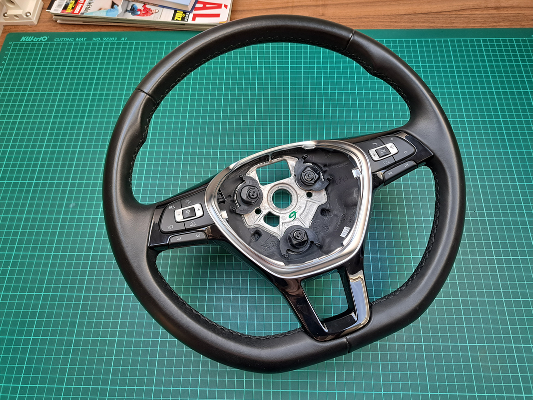

So I finally found time and courage to swap the steering wheel. For anybody else planning to do just a plain swap (not a real retro-fit to the vehicle that did not have MFSW) here are the findings.
I can confirm that if your car already has MFSW and DSG, there is no coding required.
My Caddy is 1.4 TSI DQ200 Highline spec and after wheel swap, shifting was immediately available.
My Caddy was originally equipped with 2K5 419 091 A E74 wheel with ACC.
Genuine Caddy MFSWs with DSG paddles exist in couple versions.
Top-level wheel with paddles and ACC I needed is 2K5 419 091 C EGZ
Since I could not find it anywhere I got 2K5 419 091 B ZPM (the steering wheel body is identical, just the buttons were different, without ACC) to which I assembled separate buttons and black bezel. Both buttons and bezel I sourced at Wibutec.de. Communication with them was a little bit difficult but in the end I got what I needed.
When screwing buttons onto the bezel, PT screws 2x8mm with TX8 head are used. However, for the outermost positions (closest to the wheel edges), screws have to be slightly shortened to cca 6mm.
ACC buttons part number is 2K0 959 442 A ICX and bezel is 6C0 419 685 B.
All DSG-equipped wheels for Caddy come with grey stitching (moonrock grey)
The final cost was cca 600 Euro. From what I've seen buying from official suppliers the cost would be well above 800 Euro. If anyone is interested, my older wheel without paddles is for sale, in very good condition. I will probably make a dedicated thread for that purpose and link it here.
